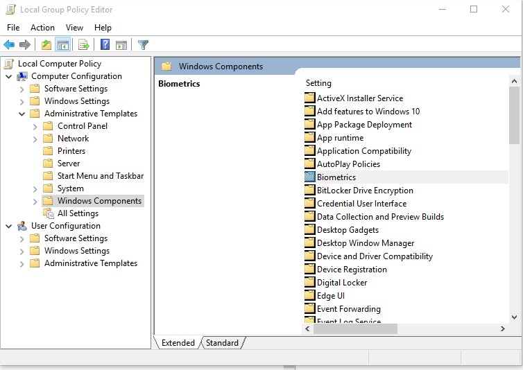

1. click on win+R ( this opens Run ) and Enter this code "gpedit.msc" as in screen shot Below
undefined
2. This will open Local Group Policy Editor
Follow the Screen shots
undefined
undefined
undefined
Double click on the " Allow the Use of Biometrics "
then enable it -> apply and select OK and close all the windows and reboot the system
