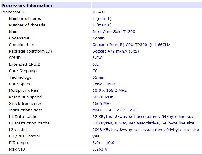

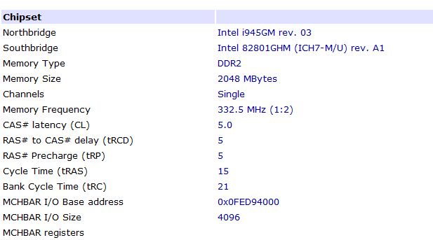

Hello LuSiD
Thanks for the screenshot. I have researched this for you and have a few questions and some suggestions.
What CPU part number is your Intel Core Solo T1300? I ask because there are two different models of your processor and each has a different socket type. Most CPU's in relation to your CPU have a BGA version in which the processor is soldered into the motherboard and Socket M socket which would allow you to replace it. The CPU part number will be important when purchasing a new laptop CPU as well. Also what BIOS and BIOS revision do you have? (you should be able to check this form the BIOS)
Intel Core Solo T1300 (BGA) vs Intel Core Solo T1300 (Socket M)
Below is a side by side comparison of the two processors. As you can see they share the same core architecture name Yonah. They both work for the same Socket M and have the same FSB (Front Side Buss) frequency of 667. The biggest improvement to performance you would see is the additional processor core and the higher CPU frequency. Something to consider is that the TDP which affects the amount of heat and electricity the processor needs is higher. The difference is four watts which can be a problem for a laptop.
Intel Core Duo T2700 (Socket M) vs Intel Core Solo T1300 (Socket M)
The Intel Core Duo T7200 that you mentioned may not work with your laptop. While they share the same socket type the T7200 is based on some slightly different achetecture name (Merom) and platform (Napa Refresh). You can see the comparison chart at the next link.
Intel Core 2 Duo T7200 (Socket M) vs Intel Core Solo T1300 (Socket M)
As for the difference between the T7200 and the T2700, the T7200 has a lower CPU frequency but gains double the CPU cache. The T7200 also uses an even higher TDP at 34watts rather than 31watts.
Intel Core 2 Duo T7200 (Socket M) vs Intel Core Duo T2700 (Socket M)
You can learn more about TDP (Thermal Design Power) at: Thermal Design Power (TDP).

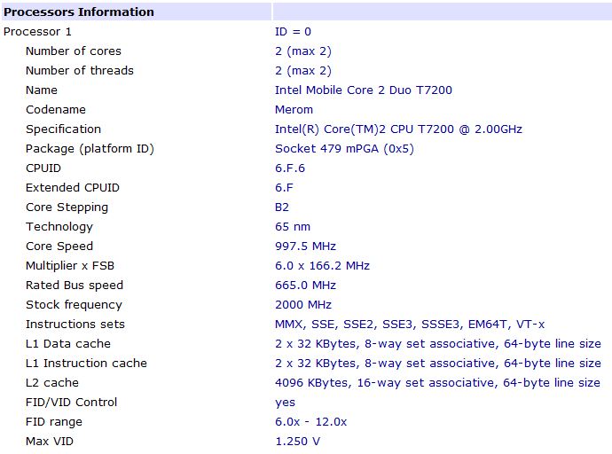

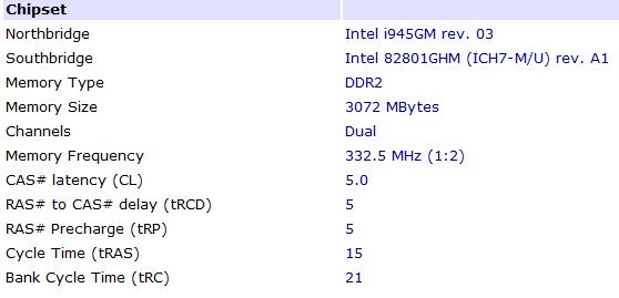

10-28-2012 11:24 AM - edited 10-28-2012 11:26 AM
OK, I have great news!
My T7200 is installed and running flawlessly!
I am very happy with this and moreover i am able to run Windows 7 64 bit and add another 2GB module to max my RAM to 4 GB, all readable from the OS.
So, for anyone else wondering about upgrading their HP 530 processor to a T7200 (or even the T7600 if you can afford it...) I would say it is a green light. Please note that my chipset is the Intel i945GM. I don't know if this upgrade wiil work on any other chipset.
As for the heat dissipation, I checked my tempratures and found that I have rather cooled results (with good thermal paste and a clean fan).
Thank you all!
