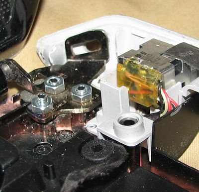

Well, the right hinge mounts in the base of my DV7-7010US broke off completely the other day.  The HP PartsSurfer says the base part number was superseded.  "Part 681970-001 is no longer supplied. Please order the replacement, 707999-001."  The new part is available on Amazon (?) and on eBay, but I'm cheap and fixed mine for a couple of dollars.
The DV7 repair manual details how to disassemble your laptop.  I used some JB Weld putty to build up the area where the mounts were broken off.  (Work quick and make sure you have it leveled.  It sets up in about 3-5 minutes.)   I used a  7/64 drill bit to drill through the case (on of the hinge mount holes lines up with an existing screw hole on the back.)  Then I used 3.0mm x 14.0mm machine screws inserted from the back and fastened with 3.0mm nuts.  Solid !
Going to try to fix it myself...
I have not re-assembled mine yet, but you will have to trim some of the plastic on the insdie of the top cover where it will interfere with the screws/nuts.
Finding the screws was a challenge.  You won't find those screws in your local hardware store or computer store.  Look for a "fastener" store near you (yp.com).  You can probably find them on eBay or at BoltDeport.com ($$).  I put a drop of nail polish on top to lock the nuts on to the screws.
Button head screws with Allen or Torx might look better.
Re-assembled successfully !
I did loose a bit of the right hand corner of the case bottom.
