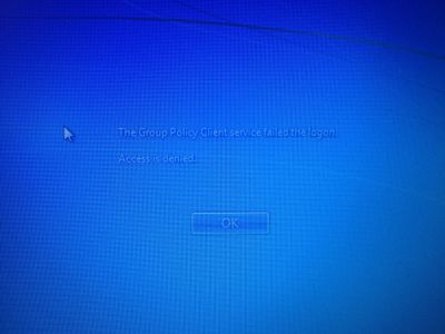

I have a HDD that was encrypted with HP ProtectTools drive encryption from within Windows7.
Computer is 8460p Elitebook.
For 2 years it started up fine and gave me no issue until my windows did not start as expected.
(The reason for windows not starting is a mix of me shifting from domain to local coupled with windows bug regarding these services)
In short: All passwords works and Windows 7 64 starts but kicks me out some way into the log in sequence.
Since I cannot start windows on the encrypted HDD I cannot decrypt the drive  ....
Since the drive is encrypted it cannot be read from outside
Since the HP PtotectTools , started from an external win 7 HDD neither can see that the drive is encrypted
Since all of this I am totally stuck.
It really sucks that although I have all passwords accessable , saved them on USB sticks and  have them in mind, cannot reach the data.
Is there any HP tool that can decrypt the drive when I have all keys necessary??
regards/Fred

Just to be clear. WIndows boots correct but due to some windows bug on group policies I cannot get in.
If I cannot get in I cannot do anything.
@Checkurtech: The drive is encrypted that means that is cannot be read from outside since there is no standard file system to read.
