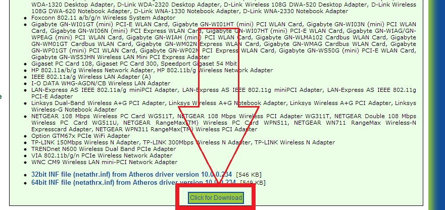

                                                                                                                        Use the Download button pointed out here

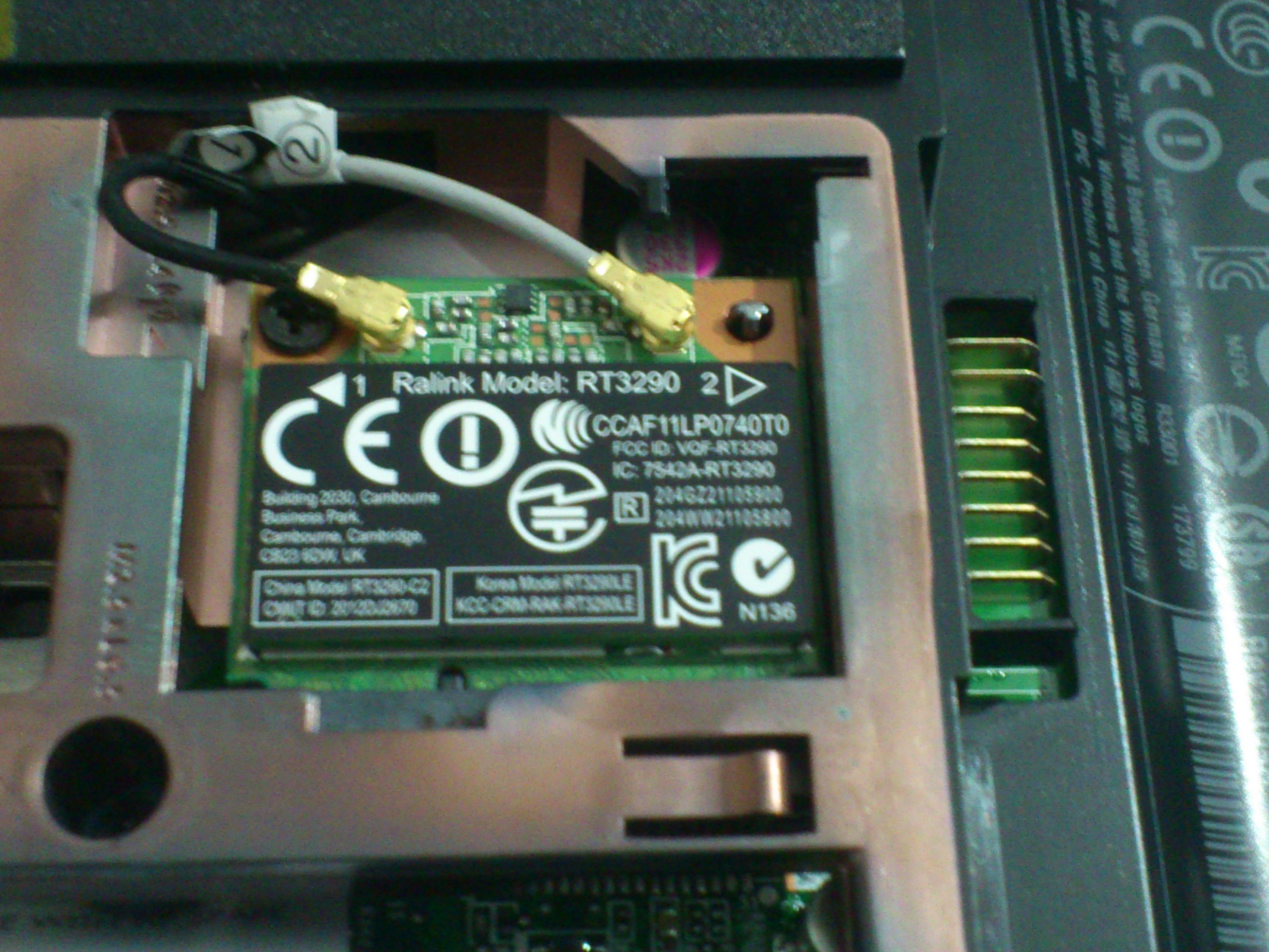

I opened the back of my laptop, and found:
CameraZOOM-20130613074739773.jpgSays chip model RT3290-C2. Are these 2 wires the antennas? The Atheros one has 2 wires also.
The Atheros is full sized, i guess :(. Because the Atheros is twice the size of the RT3290 one.
Well darn. I was hoping it was a half-size so you could at least try it. That doesn't rule out trying other wireless cards though, if you want.
