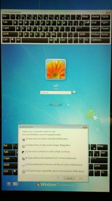

In this image, you can see that I'm using the Windows 7 Professional image (same one we ship out on the Revolve 810). All I have done, here, is to enable the Ease of Access on-screen keyboard (which you see at the top) using the dialog shown at the bottom (make sure that the box is checked, then click OK - the keyboard should pop up, and pressing CTRL, then ALT, then DEL should work fine. Don't try to press all three together - just press them in sequence. I've tested this, now, on two different units with two different BIOS versions, one joined to the domain (and as local admin AND as logged in admin user); and on one that is not joined to the domain).
This is what you should see on the screen (the top keyboard is the Ease of Access keyboard; the regular on-screen keyboard also pops up, at this point, and you can use either one):
Now, a couple of things I noticed while making sure this always worked - things that could make it appear NOT to work:
  1. If you're in landscape mode, the on-screen keyboard may be covering or partially covering the login prompt. You can touch the top bar and try dragging it around the screen to expose the login prompt, or do this in portrait mode (where the text box is usually visible).
  2. If you've ever attempted or done this before, the on-screen keyboard will not automatically appear, even though it's enabled. You will need to disable it and re-enable it to get it to show up again.
This workaround for CTRL+ALT+DEL will NOT work on a Windows 8 unit (the DEL key does nothing when pressed after CTRL+ALT). In Windows 8, you should only need to press the Windows logo key and power button together - this is related to Microsoft requirements for products that ship with Windows 8, which is an option with this one (see http://msdn.microsoft.com/en-us/library/windows/hardware/jj128256.aspx).
