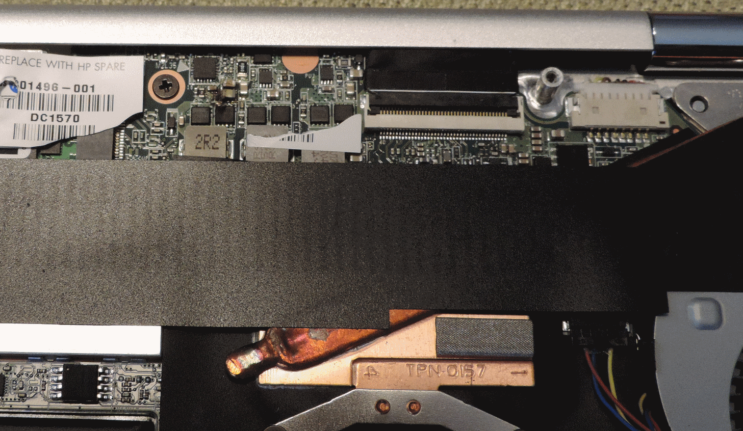

I purchased my Spectre x360 in July 2015 planning on buying a high end piece of reliable hardware.  I have had no problems with it (other than a trackpad issue that was patched soon after launch).  Fast forward to today.  I go to power it on and nothing happens.  It had been charging overnight so the battery should be good.  I check the power adapter is putting out correct voltage and attempt to do a hard reset.  Nothing.  Since the unit is out of warranty I open it up and pull the battery plug, hold power button, and then plug the battery and adapter back in.  Still nothing.  I then notice some fried caps and a fried IC under one of the stickers of the unit.  After some googling I see lots of people with this problem.  I go to contact tech support and find out I could be charged for the phone call!  Besides I don't feel like running through the "turn it off and back on" checklist when I can see the problem with my eyes.  Further googling has revealed this is a rather common problem and replacement costs are pushing the costs of the unit.  I am very dissatisfied for having something I paid over $1000 for and it not work in this short of period of time.  I put off making my laptop purchase for this thing to be released!  I recommended it to people 😞  I am hoping someone from support sees this and can help me get a replacement board since this isn't a normal wear and tear issue. HP needs to make this right.

Pic of damage:

I have the same issue. Great PC and then just dies. I need a repair or a 801505-001 replacement part
I ended up getting the unit repaired through HP at a discount.  Strangely the non-discounted repair price was more than them sending me the motherboard and doing it myself.  Anyway, my main complaint (besides paying for a design flaw) was that the warranty on the repair was only 90 days and not a full year.
