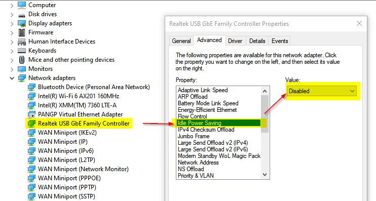

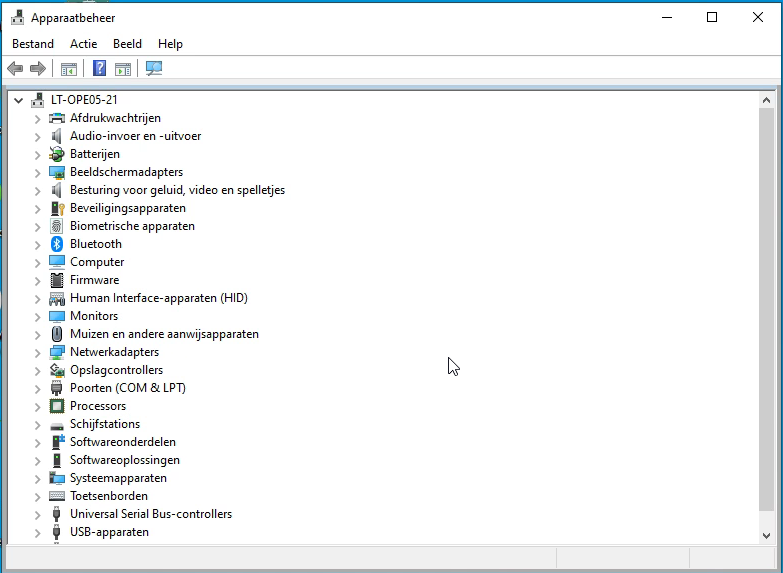

Hello here are the screenshot (sadly in dutch)
Hello ICTESS thank you for that however that option Idle Power Saving is already set to disabled Or (Uitgeschakeld) and we are still having the issue with the network dropping. We have found that this is also not just the USB-C dock in the Monitors it also happens with HP's G5 Dock
Thanks for the Screenshots, we did this here exactly as proposed an it works.
As a test, I ENABLED this Power Saving and had the drops again.
It makes sense: It occurs only with the Realtek GbE Chips that are build in the HP G5 USB-C Docks & USB-C Ethernetadapters.
We used an old USB-Ethernet-Adapter from a MacBook Pro with the HP EliteBook G8 and this also worked because it has another Chipset.
