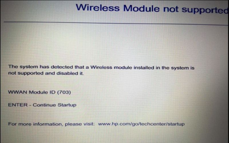

I! I have the same question. I've tried connecting an m2.SSD on the slot next to the 2nd DIMM Slot and it returns error message on boot saying that the WWAN Card is not recognized 😞
So my question is, are m2 drives supported in this slot or not ? The manual isn't clear about this.

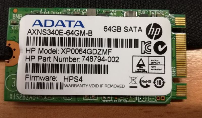

I have the same error with m.2 SSD 120 Gb 2242
ADATA 120GB SATA M.2 SSD Solid State Drive
AXNS340E-120GM-B
HP P/N 832447-001
HPE Model: XP0120GFJSL
The laptop is HP ProBook 430 G2 L8D48UT#ABA
I've installed the latest BIOS M73 0147 and firmware for SSD - HPS4
At the same time, the SSD works with M.2 - SATA adapter and if I use another m.2 SSD but 2280 - it works with the laptop.
So, I think there is some conflict between HP firmware and BIOS.
In continue...
I've bought another SSD Transcend TS128GMTS400S 2242 m.2
and it works perfectly in NGFF slot )
So I can add any sata drive as secondary if I will need it
