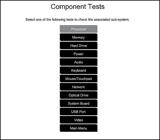

The touchscreen test can be reached by following the below steps:
Turn on the computer and immediately press Esc repeatedly, about once every second.
When the menu appears, press the F2 key.  On the main menu, click Component Tests.
Selecting Component Tests from the main menu
c05672955
The Component Tests menu displays. Your Component Tests menu might be different,
depending on the components installed on your computer.
Sample list of Component Tests
c05344823
Inside the component test, you should see an option for the Touch Screen Test.
Quick interactive test to determine if the touch screen is functioning correctly.
To run the test, click Touch Screen, and then click Run once.
