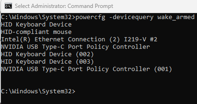

Run the following command from the windows administrators command prompt to find devices that can wake up a laptop or desktop that is supposedly turned off.
powercfg -devicequery wake_armed
for example the following devices are enabled even if the PC is turned off
They are all drawing power EVEN WHEN LAPTOP IS TURNED OFF.
Use the device manager to prevent the above devices from waking up a system

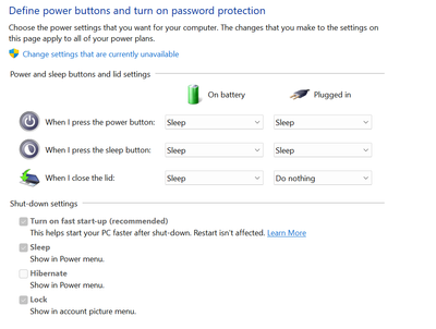

If is also possible the battery was drained because the system was put to sleep instead of being turned off.
1 - If you close the lid of the laptop to soon after clicking the windows power "Shut Down" it is possible the laptop went to sleep first.
2 - If you press the power button to turn the laptop off you probably put the laptop to sleep instead of turning it off.  Use the control panel to check the power plan and ensure that the system actually turns off when your press the power button.  Here is a typical plan and the default is to sleep.
