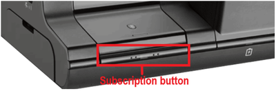

  1. While on a call, press the base subscription button. The base subscription LED flashes yellow and green.
  2. On guest headset, press and hold the Volume up button or turn the Volume wheel up for 4 seconds once you let go of the button the headset LED will begin blinking red/green (8240/8245 guest headset should get a solid white light).
  3. The primary user will hear "Conference requested." To accept the request, press the primary user's headset Call button. The base subscription LED turns solid yellow to indicate conference call mode. View conference call status in Poly Lens Desktop App.
