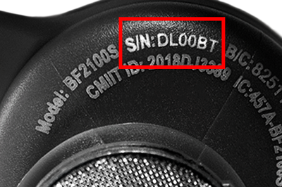

Backbeat FIT 2100 serial number and date code
The serial number for the Backbeat FIT 2100 can be identified with the letters S/N (for example, S/N: 005JYP) and is located on the inner part of the right speaker. The date code can be found next to the serial number can be identified with the letters B/C.
