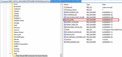

Open the Windows Registry Editor:
For 64bit, navigate to HKEY_LOCAL_MACHINE > SOFTWARE > Wow6432Node > Poly > Poly Virtual USB Connector for Zoom Rooms
For 32bit, navigate to HKEY_LOCAL_MACHINE > SOFTWARE > Poly > Poly Virtual USB Connector for Zoom Rooms
Please change the “Log_Level” registry value to 4 (debug) or 5 (Verbose Debug).
