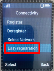

Handset Registration
  • There are 2 options a Rove 20, 30, or 40 handset can be registered to a Rove B1, B2, or B4 Base Station
    On the Base station initiate pairing using the web admin interface DECT Wireless > Handset Summary > Specify Handset and select which handset should be registered
    or
    Press the base station button for 5 seconds and then on the Handset Menu > Settings >
     Connectivity > Easy Registration
    The paired status number is indicated in the Display top right corner. 1st handset 1, 2nd handset 2 etc.
  • Once successfully paired the DECT Wireless > Handset Summary > Handset Status will show the IPEI, Status with Signal Strength, Firmware Version, Firmware Update Status, what assigned Service Provider and the status,

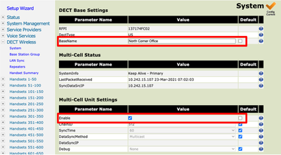

Enabling multi-cell on primary Rove B4
NOTE: A voice service must be registered on only one of the Rove B4 base stations. The base station with the registered service acts as the primary base station. >source<
  • On the primary Rove B4, select DECT Wireless > System and enable multi-cell
  • Provide a Meaningful Base Station Name
  • Select the SystemCombination you would like to support on this master rove B4.
    50 base stations / 3 repeaters
    127 base stations / 1 repeater
    254 base stations / 0 repeaters
  • Select Submit
  • Reboot for changes to take effect
Enabling multi-cell on Secondary Rove B4
  • Usually after enabling Multicell on a Primary base single or multiple secondary base stations may be deployed. On the secondary Rove B4, select DECT Wireless > System and enable multi-cell
    Provide a Meaningful Base Station Name.
  • Select Submit
  • Reboot or changes to take effect
