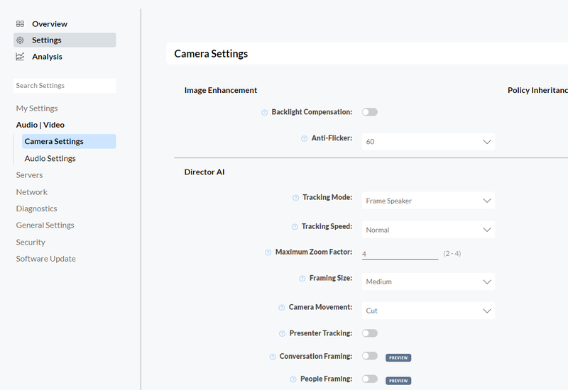

Hello @SteffenBaierUK
Thank you for that.
The option only appears in Poly Lens Cloud after it has been activated in Poly Lens Desktop. But it seems to disappear again.
Screenshot where it appears. This unit is however offline due to the other issue with the units loosing wifi connection after unplugging the USB cable used to enable the feature in Poly Lens Desktop.

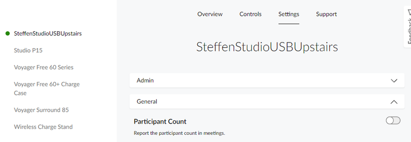

Hello @GTCPH
not on my unit running 2.1.2 connected via WiFi
Best regards
