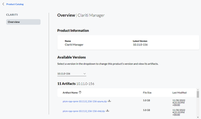

In Lens under Manage > Licensing > Clariti > Product Catalog > Clariti Manager virtual Machines files can be found

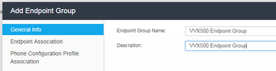

  • Using the Endpoint Groups as an example we can add and Group certain Endpoints together. In the below example we used a VVX500
    We call this new group VVX500 Endpoint Group
    And we associate this:
    This results in a new group

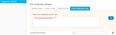

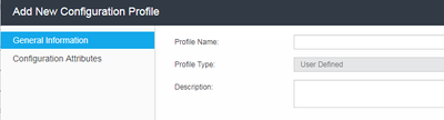

  • Browsing to Endpoint > Phone Management > Configuration Profiles you can either create a new profile/configuration (blue) or modify an existing one (red) once it is selected
    Either create and define what this profile does or change the name provided if cloned
    The options for editing or changing this vary
    You can simply start typing/searching for a parameter(s)
    or paste from a previous XML file

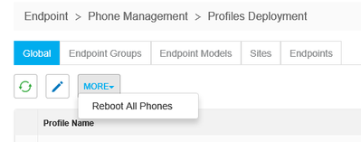

Advanced Functions – Global/Model/Site
Reboot Phones – All phones within the selected scope will be rebooted as long as they are not isolated behind a NAT’d device.
