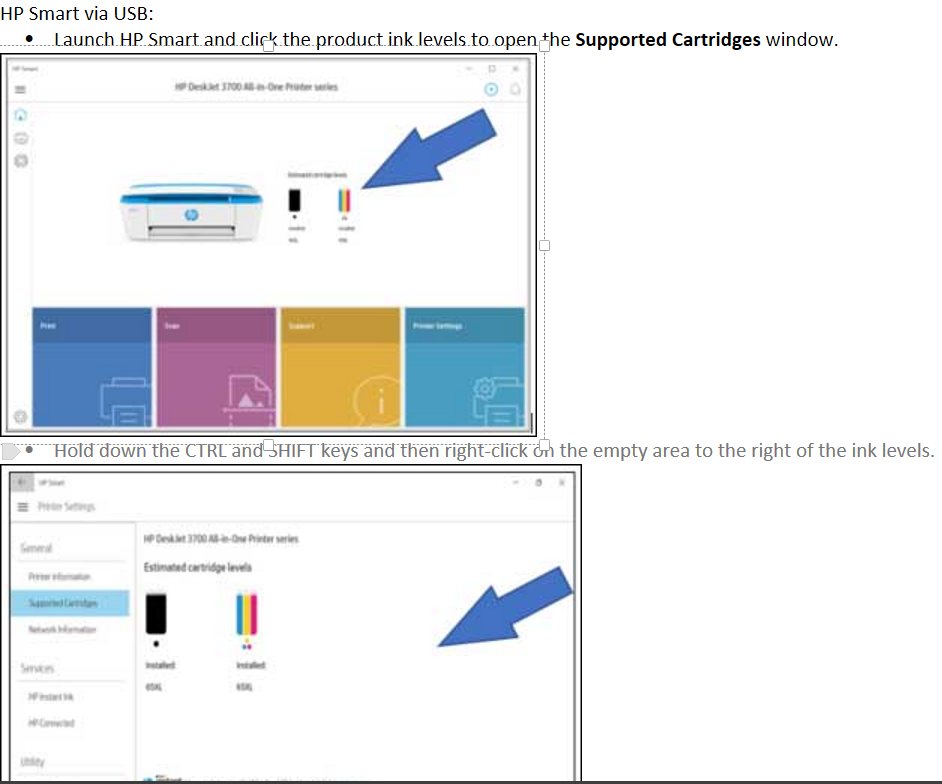

Hi @Jeff434
I can surely help you with the regional reset. If the above criteria are met.  I request you to please continue with the steps below.
Please follow the steps below.
1.) Connect the printer via USB (usually you need it in case your internet connection is not strong or may have downtime while performing it. You can skip it and perform the process under wifi as well)
2.) Launch HP Smart and click the product ink levels to open the Supported Cartridges window.
3.) Clicking ink levels in HP Smart
Hold down the CTRL and SHIFT keys (Cmd + Space in MAC) and then right-click on the empty area to the right of the ink levels.
4.) Clicking to the right of the ink levels
The Set New Regions window opens.
please share a screenshot of this window with me
Use the "Copy to Clipboard" feature to paste the values in a private message..
To access your private messages, click the private message icon on the upper right corner of your HP Support Community profile, next to your profile Name.
Note: Do not share any of your personal information such as serial, phone number, email ID, etc.

Hi,
I installed HP Smart, I see the printer but the action of CTRL SHIFT and right clicking next to the ink level is a bit unclear to me because I can't see any region window poping up. Would you have a video or some screen shots to show where to click and in which menu selection?

Hi @Jeff434,
Thank you for your response. I have shared the steps I hope this helps.
Please mark this post as “Accepted Solution” if the issue is resolved and if you feel this reply was helpful click “Yes”.
