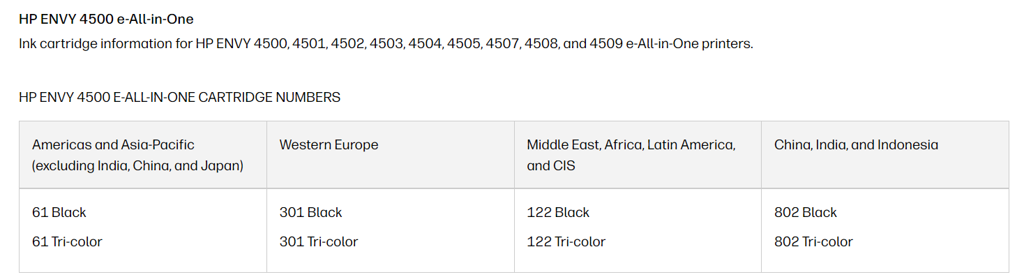

May I know if you have changed the region?
Refer to this document: HP ENVY 4500 e-All-in-One Printer series User manual
