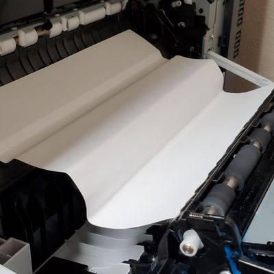

I'm having a issue with constant printer jams. I've included some photos of how the paper jams.

One more thing... here is the picture of the paper
Notice it's getting bent on the corners? I don't understand what is blocking it. And yes I've cleaned everything.

Check the mylar strip on the registration sensor assembly. They are easily bent and result in this type of behaviour.
