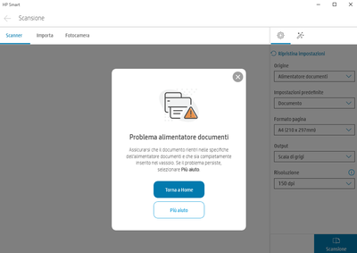

My document or documents feed fine, but the scanner does not seem to be able to detect the end of the document. When scanning a single page document the document feeder continues to run and run even after the single page has been fully scanned. When scanning a multi-page document, the document feeder picks up page after page successfully, but after the final page fully runs through the scanner, the document feeder continues to run and run. In both scenarios (single page or multiple pages), after the final page has run through the feeder, the feeder continues to run and ultimately results in an error.
On the small touchscreen of the printer itself, I get the following error message:
The document feeder was not able to pick up the original. Make sure the document feeder cover is closed completely, load the original in the document feeder, and try again.
As previously stated, these errors occur after the last page has been fed through the feeder. It looks like the scanner/feeder is having trouble identifying the end of the document.

Hi Alden4,
I tried all what you suggested.
The printer is clean, the page is detected, the problem is that scanner does not detect the end of the document. I tried 1 or more sheet.
I resetted it, and i installed last firmware, and tried to scan from HP smart APP.
Nothing to do. I'm still convinced it's a software problem and not an hardware one.

Hi Irwin,
as described in my first post and also in the others I red in the community, the issue is indipendent from the software on the PC, even if I start a copying directly on the printer the document feeds doesn't recognize the end of the document and show an error in the display. I'm not the only one with this issue on this printer series. I think HP have to investigate and solve with a firmware update. Thanks anyway.
