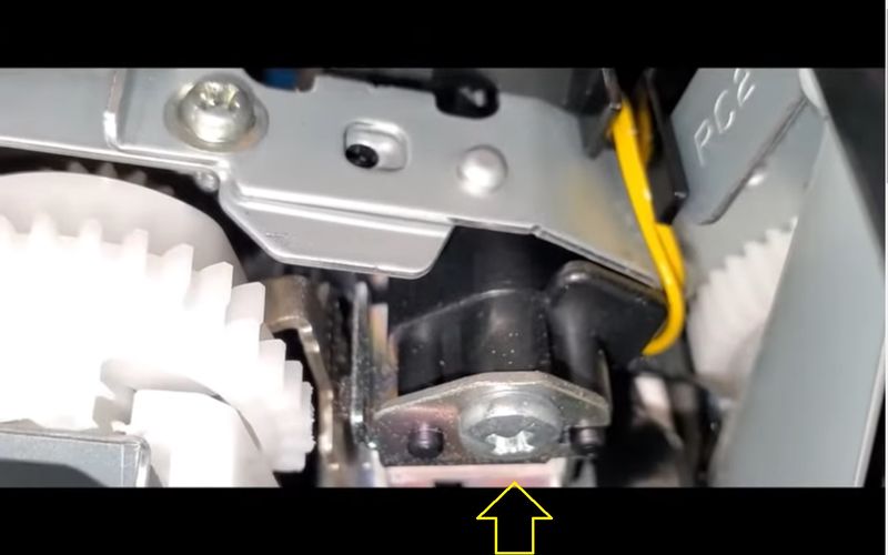

In order to replace the flapper solenoid which is located in the upper body of M451dn., I would like to find its part number. (It may be RM1-5420-000, RM1-5423-000, and the like.)
Thank you very much in advance for your kind attention.
HP_FlapperSolenoid.jpgHP_FlapperSolenoid_TearDown.jpgRM1-5420-RM1-5423-RM1-9006-RM1-9007-hp-cp2025-2320-m351-451-m476.jpg_ (1).jpgRM1-5420-RM1-5423-RM1-9006-RM1-9007-hp-cp2025-2320-m351-451-m476.jpg_ (2).jpg

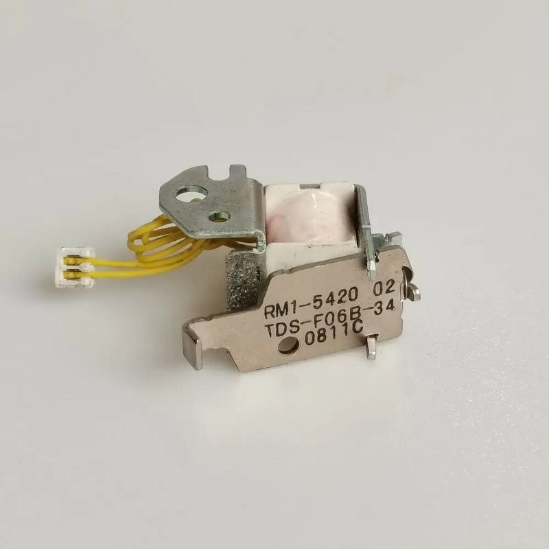

https://www.partshere.com/online/detail.asp?partno=RM1-5420-000CN
(TDS-F06B-34)
https://www.partshere.com/online/detail.asp?partno=RM1-5421-000CN
(TDS-F06B-33)
https://www.partshere.com/online/detail.asp?partno=RM1-5423-000CN
(TDS-F06B-32)
https://www.partshere.com/online/detail.asp?partno=RM1-5426-000CN
https://www.partshere.com/online/detail.asp?partno=RM1-54261000CN
(TDS-F06B-xx solenoids were manufactured by http://www.tdsjp.co.jp/english/product/flapper.html .)

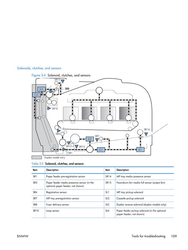

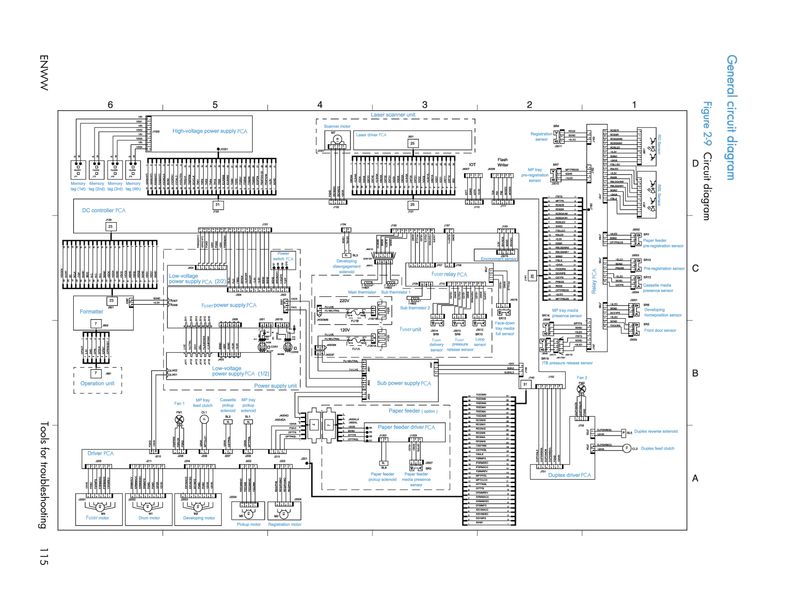

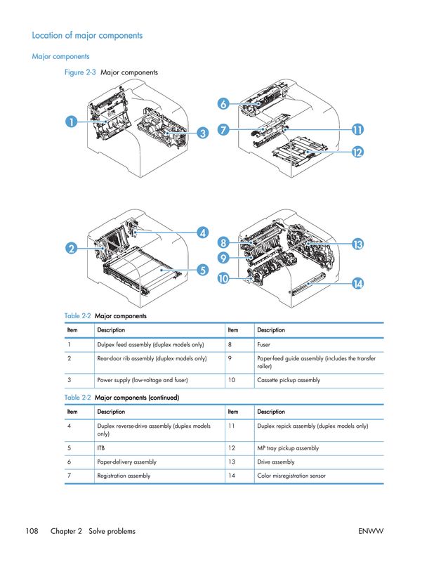

The solenoid in question may be referred to as "Duplex Reverse Solenoid" in the service manual.
HP_M451_solenoidsclutchessensors.jpgHP_M451_majorcomponents.jpgHP_M451_circuitdiagram.jpg
