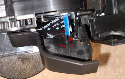

Picture below are of my removal (the manual is not clear)
  • Removing the locking tabs is difficult as they will self-rotate and jam. Manual says to use a screwdriver to pry them out, but that did not work for me, and I found it better to use a pair of needle nose pliers.
  • Lift the assembly carefully, guiding the ribbon cable out

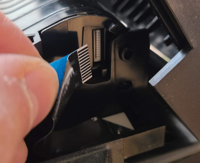

Step 19. Clean the contacts at the end of the ribbon cable with isopropyl alcohol, and plug it in. Note the ribbon routing.
