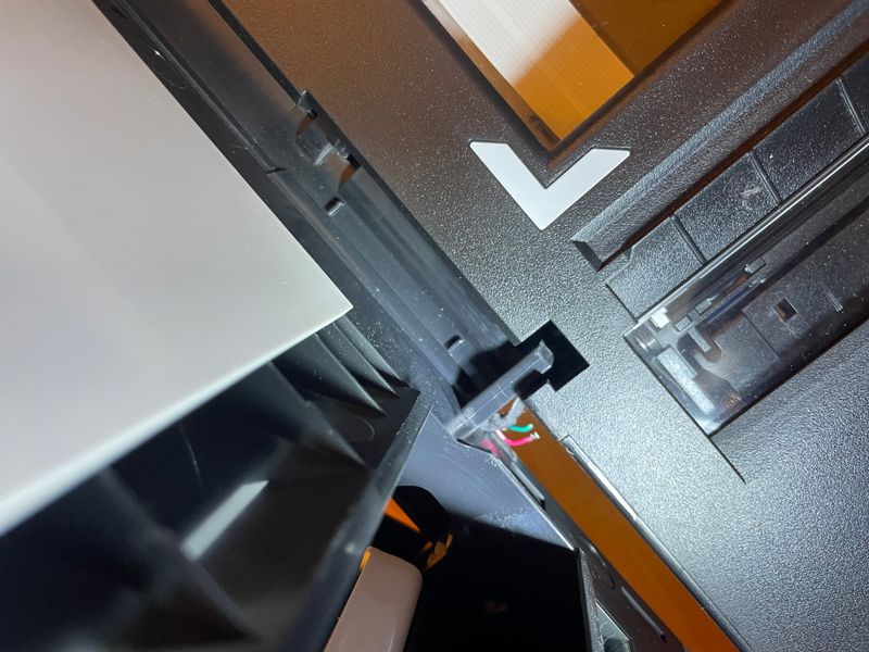

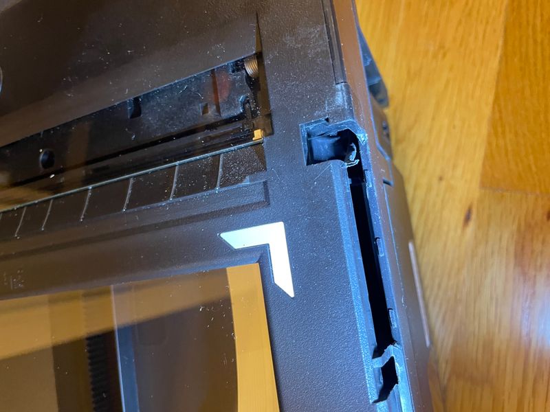

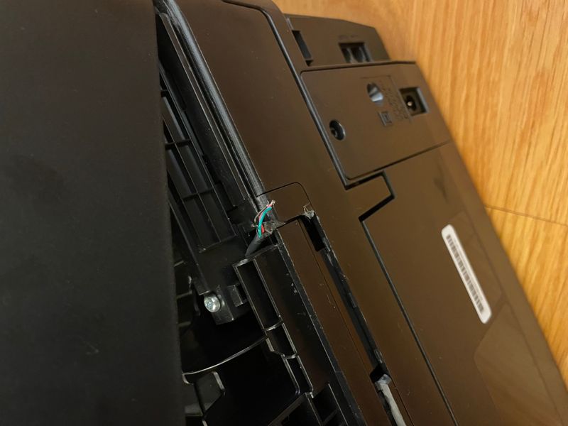

I resolved this issue by fixing a broken wire that runs from the ADF to the central processing unit. The wire, by my guess, feeds the CPU on the status of the automatic paper feeder. When it is damaged/broken, the CPU can not determine the status of the document feeder and continues to "search" for additional pages, until it times out and eventually results in a cancelled scan.
The wire location is near the backside of the "hinge" when you open the scanner top to access the glass flatbed. Viewing from the top, it is on the upper left corner. See attached picture. The wire somehow becomes jammed between the hinges. As time goes by, it was worn off and broken apart by the mechanical movement of the hinges, if one open the scanner top often. It was not obvious in the beginning before I took apart the printer, as the wire is actually somehow hidden inside the hinge. In the pictures below, as I open up printer and took out the wire and it became obvious the wire is broken inside. There are 3 color wires running inside a bigger black jacket. Once I cut open the black jacket, the color wires are exposed and shown the damage. It took me quite some time to disassemble the printer, reconnect the broken wires via soldering and put them all back. It has worked flawlessly ever since.
This most likely a design flaw of the printer, as this wire runs too close to the hinge. A minor assembly offset could result in mechanical damage of the wire.
