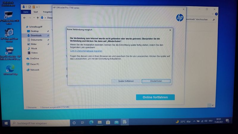

Neuer HP OfficeJet Pro 7740  wide AIO
Am Ende der Installation kommt die Meldung "Keine Verbindung" mit Erklärungen, Wiederholungs-Button und Link, um später die Aktivierung fertigzustellen. Mit dem Link läuft alles nochmals von vorne. LOOP.

New HP OfficeJet Pro 7740 wide AIO
At the end of the installation, the message "Unable to connect" appears with explanations, a repeat button and a link to complete the activation later. With the link everything starts all over again. LOOP. Until the error occurs, the installation of the version with full functionality seems to run normally.
   OJ7740_Full_WebPack_40.12.1161_1.exe
At the bottom, you will find the foto and screenshot of the error-message in german an english.

20210815_022254.jpg20210815_022254.jpg20210819-20200831 Screen Unable to connect.JPG20210819-20200831 Screen Unable to connect.JPGThank you for real help!
