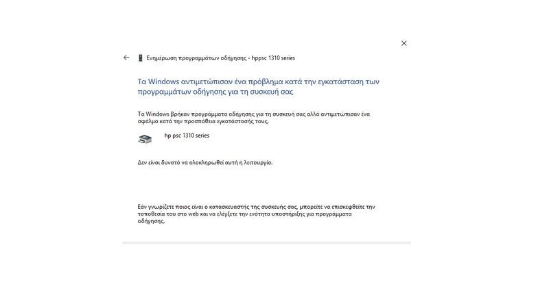

After Windows10 update 1803 (27 Nov 2018) I lost the HP deskjet 1315 printer And the HP 2050 ( MY HP LASERJET P2035n WORK OK ) !!! My PC is HP Pro 3500 i5 8gb ram.
Windows finds a program but does not complete the installation by giving this answer.
"Windows found drivers for your device but encountered an error while trying to install them".
uninstalled all HP drivers downloaded from HP https://support.hp.com/gr-el/drivers/selfservice/HP-PSC-1310-All-in-One-Printer-series/360489/model/...
AIO_CDB_NonNet_Full_Win_WW_140_408-4.exe
but the driver's installation is not completed.Οnly the drivers the programs are installed οκ.
Looking at the web, I see that a big world has the same problem with the latest upgrades of Windows 10. What is going on now?

I did everything over but nothing is done. I forgot to say that the same is done in the bugs samsung i 5 windows 10 1809. 17763.253 23/12/2018. The problem is Microsoft has done it while it finds the driver at the end of the installation makes a mistake. The printer scanner is working normally. I've spent many hours on this problem I can not do it anymore. Should Microsoft with HP find the problem and resolve it. I have two HPPSC 1315 and 2050 useless printers.
The PC is HPPRO 3500 i 5 Windows 10 for ver 1809 -structure 17763.253
translation of the above
Driver Information - hppsc 1310 series
Windows encountered a problem installing the drivers for your device.
Windows found drivers for your device but encountered an error while trying to install them.
it is not possible to complete this operation.
If you know who your device manufacturer is, you can visit his site on the web and check the driver support section.

I did all that you suggested to me, but nothing was done. Windows finds the HP PSC 1310 drivers but the middle of the installation makes the error.
(Driver Information - hppsc 1310 series
If you know who your device manufacturer is, you can visit his site on the web and check the driver support section).
