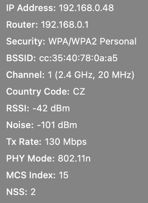

The wireless status menu on your Mac should also give us quite a lot of information that would help us identify the issue. You can press and hold option-click the WiFi icon and then use shift-command-5 to take the screenshot. Press the space bar when the icon turns into a camera. Share the ping test results and the screenshot with us.

I have the same issue. I'm attaching my ping and my wireless info. But the thing is, this answer is needlessly complicated. The only thing that has changed is that Mac OS has been updated to the latest version 12.5.1 — I didn't need to move to a different location before this update, or ping my IP address, or check my wireless. Shouldn't there be an automatic update from HP to solve this issue?
Thanks for your help.

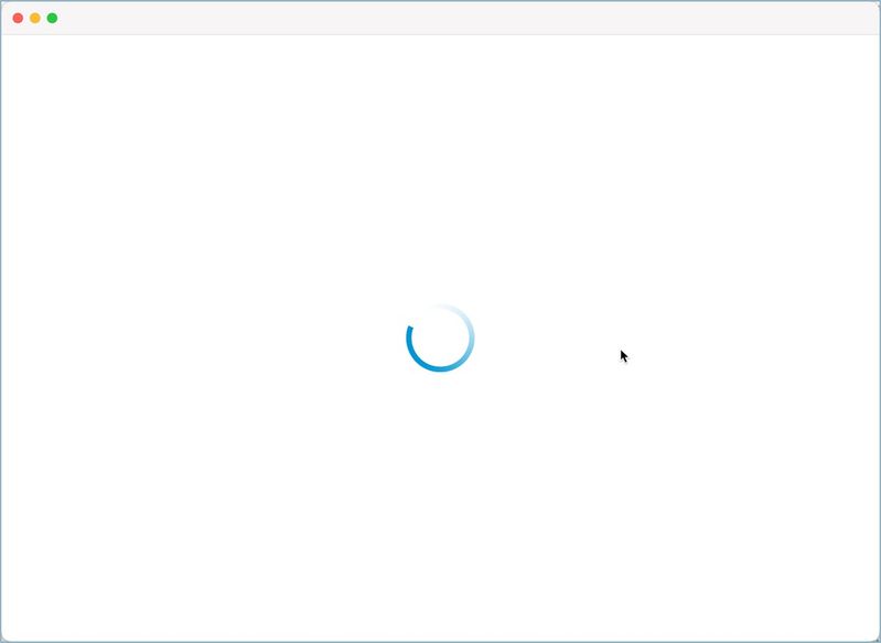

I am running macOS 12.5.1 Monterey and now am unable to successfully open HP Smart.
The screen pops up with a blue outlined circle that is animated to show it's doing something.
But it is stuck on that screen.
I can still print just fine but since I am unable to open HP Smart, I can no longer scan anything.
From System Preferences > Printers & Scanners > Scan > Open Scanner, the "Scan" button is grayed out.
Screenshots for reference.
HP, please help!!!
Thank you.
HP Smart on macOS 12.5.1 won't open successfully.jpgHP printer cannot scan from System Pref.jpg
