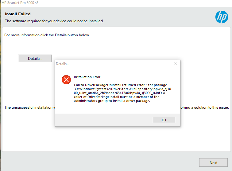

I have tried everything I can think of to install the drivers for my ScanJet 3000 s3 on my new computer.  Downloaded it from HP and got the error message:
"Call to DriverPackageUninstall returned error 5 for package "C;\Windows\System32\driverstore\filerepository\hpwia_sj3000_u.inf_amd64_2f69aabec63417a6\hpwia_sj3000_u.inf": A caller of DriverPackageInstall must be a member of the Administrators group to install a driver package."
The problem is that I am the only person using this computer, so I am the administrator.  I double checked on that.  I also created a second "administrator" account and logged in using that one to see if the install would go through.  Same error.  I also tried, instead of downloading the entire driver package, to just download the actual basic drivers.  Same error.  Please help!!

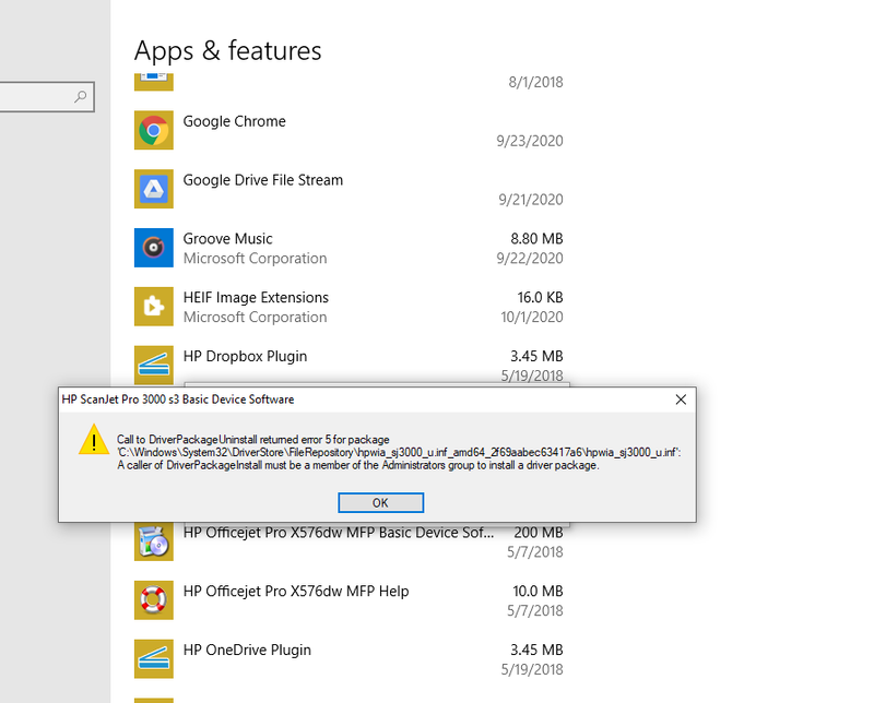

  • From the Start menu click the Gear icon, select Apps and uninstall the HP Basic Device Software for your printer and evaluate the error message, then close the Uninstall dialog.

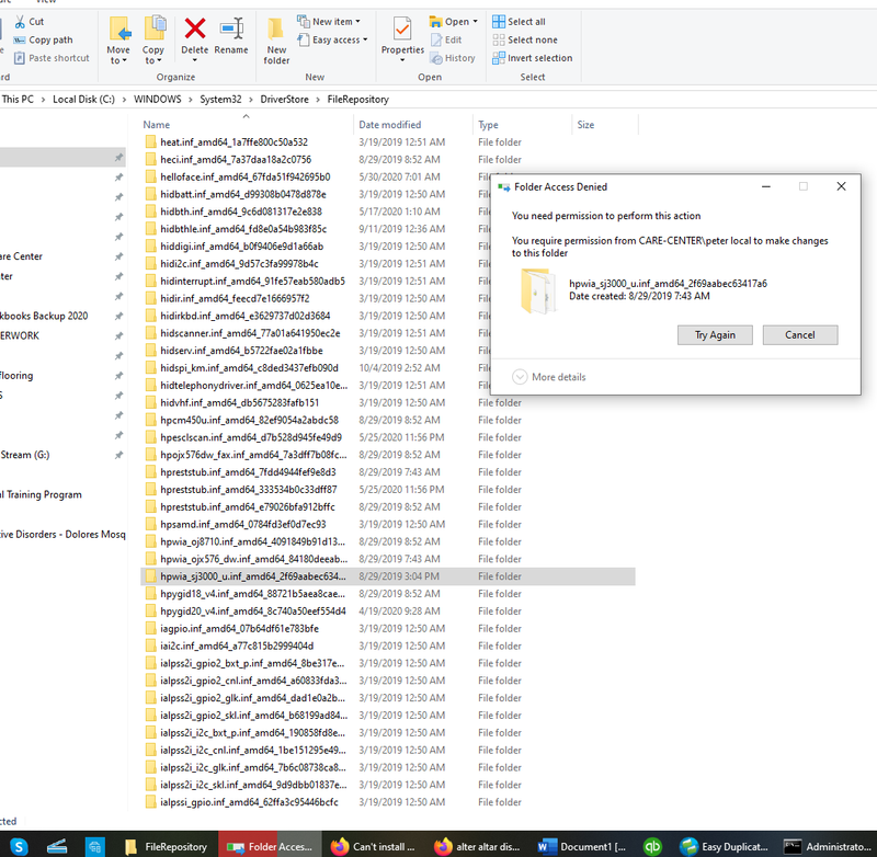

I tried the steps under what to do if you have a HP PC.  When I tried to uninstall the specific file I got another error (potentially saying something similar) which is I need admin permission to delete a file except I AM THE ADMIN!  There aren't any other profiles on my computer.  try #2 scanjet drivers.png

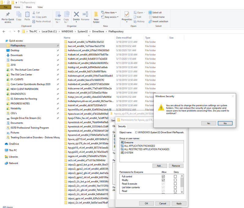

I DID IT!!!!  It required one additional step.  When the system told me only an administrator could delete that file I went into the properties of the file and changed the security to "EVERYONE."  I am going to try and enclose 10 screenshots of what I did from start to finish in case it's helpful for anyone.  Running Command Prompt As AdministratorRunning Command Prompt As AdministratorAfter I hit enterAfter I hit enterAfter I cut and pasted the lines from your assistAfter I cut and pasted the lines from your assistThen I tried to remove the driversThen I tried to remove the driversThis is the error message when I tried to remove the driversThis is the error message when I tried to remove the driversThis is the error message saying I didn't have permission to delete the fileThis is the error message saying I didn't have permission to delete the file8.pngThis is an example of changing the settings for the folder (different folder than the one I actually changed since it ended up deleted per my request)This is an example of changing the settings for the folder (different folder than the one I actually changed since it ended up deleted per my request)I selected "YES" to change the settings, then it allowed me to delete the file, the installation went perfectly.I selected "YES" to change the settings, then it allowed me to delete the file, the installation went perfectly.
