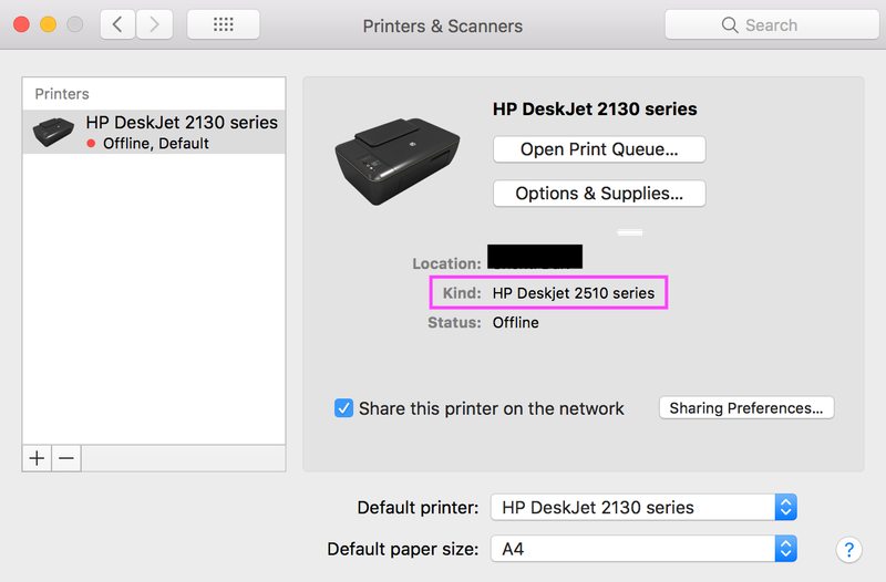

Step 1: https://support.apple.com/kb/DL1888?locale=en_US > Head over to this link. It is Hewlett Packard Printer Driver (version 5.1) provided by Apple on 24th Oct 2017. I came across this while hunting for the solution to this problem in one of the discussions on HP Support itself. It is a heavy download but at least we aren't stuck with HP Easy Start. Download and install this driver. No, HP Deskjet 2131 isn't listed as a supported printer model. Yes, this will still work.
Step 2: Once you've downloaded and installed the printer driver, head over to System Preferences > Printers & Scanners > Remove any printer that may be already added. Like a fresh start.
Step 3: Click on the + button and find your printer (Which should show up considering you've had it connected to your MacBook / iMac all this while via USB) DO NOT press 'ADD' as yet.
Step 4: Before pressing 'ADD', under the options provided for the 'USE', click on select software. Now, because you have just installed the printer driver, a big list of printers will be shown to you. From this list, choose 'HP Deskjet 2510 Series'. No, this isn't our specified printer. Yes, this will still work. Yes, at this point, I am willing to try anything because I want to move on in life.
Step 5: Upon choosing 'HP Deskjet 2510 Series', confirm by clicking 'ADD'
Step 6: Your printer icon in System Preferences will show that green light and you will smile thinking, 'Okay! This used to happen when I added my printer previously as well. What now?' Now, close System Preferences.
This is how your Printers & Scanners window should look. Note the pink rectangle. Excuse the red light of my printer. I'm in bed.This is how your Printers & Scanners window should look. Note the pink rectangle. Excuse the red light of my printer. I'm in bed.
Step 7: Open a snazzy photograph of your dog > Cmd + P > Print.
You are most welcome.
Thank you SO much. This has completely solved my same problem with a OfficeJet 3830 and a wireless connection on my Mac High Sierra 10.13.1. Got no help from HP but you and that obscure Apple link have sorted me out. Lots of people on this forum are expressing great frustration with the same problem and I hope they find your post. Kudos!!!
