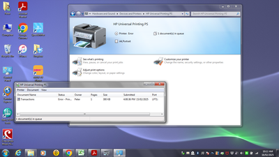

I am trying to print from an old laptop running Windows 7 (64bit) to a new Envy 6530e printer.  I have it working on a new desktop running the latest version of Windows so there is nothing wrong with the printer.  I have downloaded the Universal Print Driver and the printer is visible in Settings - Devices and Printers but when I try to print a test page it comes up with an error.  Is there  a configuration I need to change in the print driver to get it to work?

Hi BeemerBiker, thank you for the quick reply.  To answer your first question here is a screenshot of the error message and the dialog box that opens when I select the Printer: Error tag.
I have tried both versions of the UPD (PS and PCL6) and both give the same result with pdf files and other files. Do you have any other suggestions that could resolve it?  Thank you.
Your printer is on the network, is that correct?  if so, the port should be a WSD port, not an LPT port.  WSD was first introduced in Vista and your win7 system should find the printer and assign a WSD port to it.
