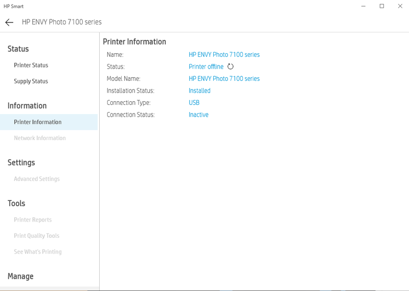

A new problem has occurred in where the printer is on and connected to the computer via USB but HP Smart shows the printer as offline.
I click on Printer Status, click "Diagnose & Fix", and shows that no issues were found. I clicked on "Test Print" and it succeeded to print. So there is confirmation that there is a connection between the printer and the computer. I want to think this is a software problem. What is needed to fix this?printersnip.pngprintersnip2.png
@Jororo
Thank for posting back.
HP smart app only works with wifi connection and it does not work with USB setup.
Please download the full feature printer driver for Advance print settings.
Click here:https://support.hp.com/us-en/drivers/selfservice/swdetails/hp-envy-photo-7100-all-in-one-printer-ser... to Download.
Keep me posted for further assistance.
ECHO_LAKE
I am an HP Employee
I have already downloaded the Full WebPack and installed it since it was the link that was given by the other person/bot helping me. Am I suppose to uninstall and then reinstall?
Yes @Jororo
Un-install the driver and then re-install it.
Keep me posted.
Asmita
I am an HP Employee
