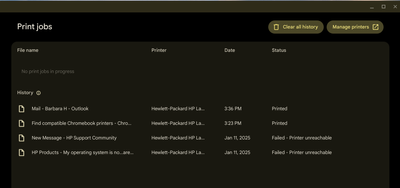

Rachel thank you for taking the time to provide such a thorough response.  I have tried and re-tried all of the steps suggested.  All of the conditions have been met and this time, after re-starting the Chromebook and attempting to print two documents, the status indicates that the documents have been "Printed" in the "Status" column of the screenshot below, but no activity (not even an attempt heard) by the HP LaserJet m1212 MFP.  Given this result, is the conclusion that the HP LaserJet m1212 MFP is not compatible with my Chromebook?  I was trying not to have to buy a new LaserJet printer so wanted to exhaust all troubleshooting options.  Thank you again.  Barbara

Thank you for taking the time to try to help.  I have downloaded the Printer Driver you suggested.  I went ahead and restarted my Chromebook, then removed and re-added my HP LaserJet M1212nf MFP.  I was prompted via pop-up to select whether I wanted the plug in to be used when printing, I selected yes.  Then I selected a file from my Google Drive to print, the printer was available for me to select as the destination to which to print.  Nothing printed.  I navigated to the Print Jobs,  and next to the document I attempted to print is the top message from today in the screenshot below:  "Failed - Printer unreachable" message.
Any other suggestions that you can recommend I try?  Thanks for your help FerRX.
