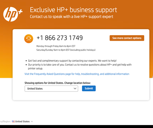

  • Hope this information is helping you in the installation of your printer. 😊
