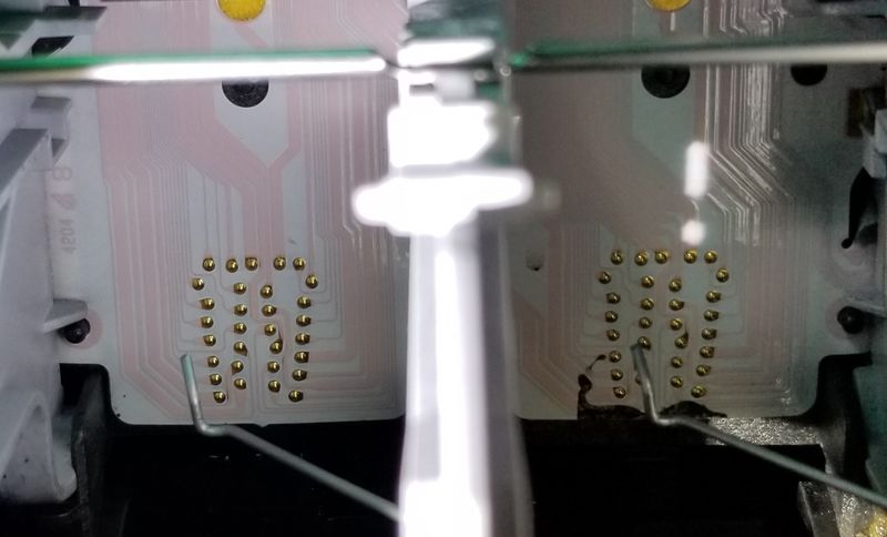

It might help if you could take a picture of the printer and post it here.  I would suggest removing the cartridges and taking a picture of the electrical contacts in the printer, both the color and black side.  Save the picture to your PC and then use the "Insert Photos" link (the camera icon, 2 spaces to the right of the smiley face) to post the picture.  I am not sure I will see anything, but maybe.  Please use a high resolution and get as close as you can, something like this:
The above is from my Photosmart 2710

Well, here is the photo.  Doesn't look like much to write home about, though, eh?IMG_3189.jpg
The contacts look pretty good.  You might take a damp Q-Tip and scrub a bit right to left in locations 1 and 2 in the photo below.  I zoomed in on this area, it appears there may be some corrosion or debris in these areas. Also, it would not hurt to wipe away the fiber in the color section, label 3.

Well, I gave it my best shot, but no dice....It's OK...just another lesson in life...some things are just destined to remain a mystery, for eternity....Thanks again!!
