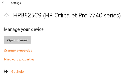

I keep ending up with this:
When I click Manage only the scanner:

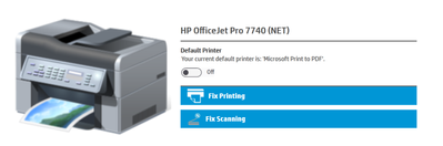

When I start HP Print and Scan doctor 5.6.2, I see 2 printers in the network (the are the same printer):
When I select one and press next:
I click fix printing, I get:
