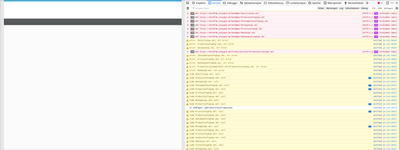

Two printers have the same problem. A blank page is loaded from the EWS. Opened from several different browsers (Chrome, Firefox, Falkon). Scan to network folder does not work. How to fix?
Screenshot web pageScreenshot web page
Error. Attempting to scan to a network folder.Error. Attempting to scan to a network folder.
HP LaserJat Pro MFP M428fdn and HP LaserJat Pro MFP M428fdw. Firmware Revision: TETONXXXXN002.2322C.00. Ethernet connection (wired). Ping to printers is available.
Web Access Test Results: No problems found. Your printer has access to the Internet, which is required for Web service.
Printing works on computers configured before the problem appeared. And scanning from a computer works via ethernet.
Does not respond to Setup>We Services Setup>Print Info Page.
Chrome DevTool Console (part 2)Chrome DevTool Console (part 2)
Chrome DevTool Console (part 1)Chrome DevTool Console (part 1)

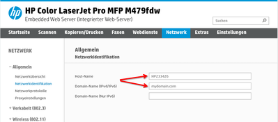

You can also use the host name configured in the printer:
https://hp233426.mydomain.com/

Screenshots  (left EWS, right firefox console)

We found out what was causing this issue for us, and a workaround, as follows:
- We were using a hostname (printer, what else!) to connect to the EWS, rather than the actual IP address. Hostname added to the Windows hosts file. So using a URL https://printer generates this error.
- When we tried to access via IP instead, e.g. https://192.168.1.200, it loads fine.
I'm not sure why the hostname rather than IP address should fail, but looking at some of the other posts I see here I guess it is some kind of known issue. Any, this workaround is good for us for now, but would be preferable to have it fixed in a future firmware.
