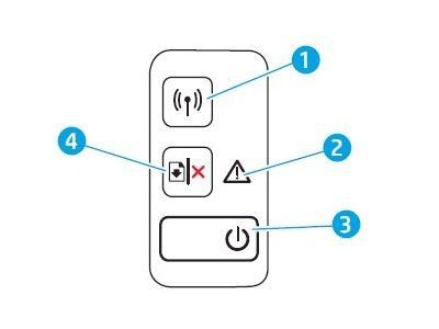

Turn off printer by pressing power/ready button (button 3 in picture below).
While printer is off, press and hold the resume/cancel button (button 4 in picture below).
While holding the resume/cancel button, press the power/ready button to turn the printer on.
Continue holding the resume/cancel button for 20 seconds.

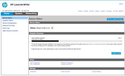

According to the config print out (from holding the resume/cancel button the direct connect settings have been reset to the defaults. However, when accessing the EWS for the printer (see image below) I cannot access the System or Networking tabs, and there does not appear to be anyway to reset these settings back to the default.
When I do attempt to access those features, I am presented with a logon screen for which I do not apparently have the current credentials for.

Yep - I have been able to get that far, but when clicking on the System tab to get to the next step, I am presented with the following:
This is the point that I cannot proceed beyond. The Username/Password is the sticking point. I need to find some way to reset this to the defaults so that I can change these credentials to secure the printer.
