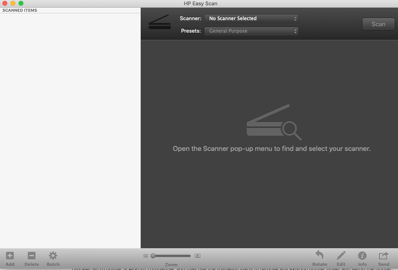

To get to the OP's point about setting up scanning on an HP printer: EasyScan is useless - check it out!
How can that be? I have a printer up and running, the printer has a scan, all HP software driver versions up to "Version Easy" were able to print and scan without a problem. But - alack and alarum - there be no printer that I can see ("Arr, Matey!")
Shall I hear more, or shall I speak at this? Through the fillings in my teeth I can hear the HP expert on the other end speaking tinnily but sharply, as though with clenched teeth xemself: "Well...you must *add* the scanner!" Hmmm, let's see what the options are to add a scanner through EasyScan:
There are exactly 2 (two) options: Bonjour (which only works on current subnet) and USB (which requires direct connect).
So - to inform HP on how their corporate software actually works: if you have a printer on one subnet and a computer on another, you just ain't being Easy. HP won't play.
