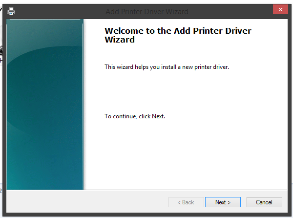

I clicked yes and the Add Printer Wizard showed up:
