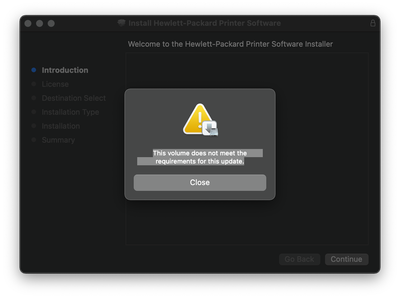

I'm on macOS 11 Big Sur.
This doesn't install HP Laserjet 1020 nor HP Laserjet 1022 printer drivers for macOS 11 Big Sur.
When mounting the drivers downloaded here https://support.apple.com/kb/dl1888?locale=en_US
I get: "This volume does not meet the requirements for this update.", most likely because I'm on macOS 11, not max OS X.
After uninstalling previous HP Laserjet 1022 driver, I'm left with no supported drivers and can no longer use my HP LaserJet 1020 printer.

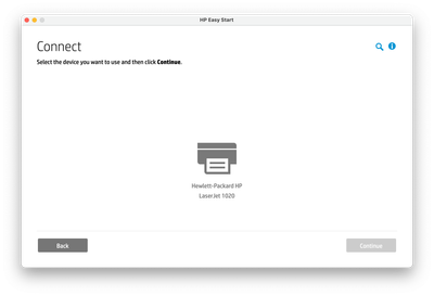

01-09-2021 07:05 PM - edited 01-09-2021 07:06 PM
The HP Laserjet 1022 driver used for my HP Laserjet 1020 available in PrinterDriver.pkg at ftp://ftp.hp.com/pub/softlib/software12/HP_Quick_Start/osx/Installations/Essentials/ASU/ solved my problem, thank you!
Note, I tried the Gutenprint solution first and that did not work for HP Laserjet 1020 using HP Laserjet 1022 driver.
