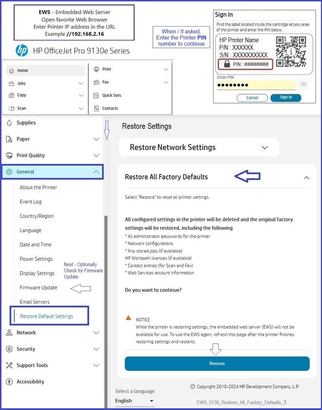

Reference and FYI only
Open your Browser > Type / enter the Printer IP address into URL / Address bar
Section General > Restore Default Settings > Restore Network Settings OR Restore All Factory Defaults
EWS > General > Restore Default Settings > Factory
EWS_9135_Restore_All_Factory_Defaults_3
