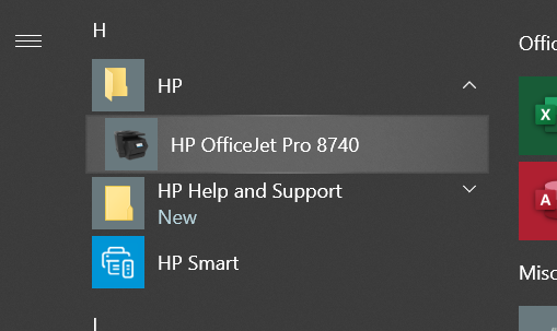

When I click on "HP OfficeJet Pro 8740" in my Start menu, it takes me to a box which asks "Do you want to allow this app to make changes to your device?" and it lists "DeviceSetup.exe" as the app. First off, before all this upgrading fiasco, it never asked me that.
In other words, I no longer get the main printer program I used to get. For kicks, I click on "Connect a new device" and it takes me through finding the printer on my network, then it says it's installed, then it asks me to register it.
But after doing all that, I still don't have the original printer program I used to get when I clicked on "HP OfficeJet Pro 8740" in my start menu. It keeps doing all of what I described above all over again.

OK, I did that. The problem persists.
As I said in my original message, the printer DOES work, I CAN print to it. But I cannot run the desktop software (see below), titled "HP OfficeJet Pro 8740".
When I click on that, it does what I described in my original post.

That worked, thanks. I guess what was needed was a more thorough uninstall/reinstall, and your steps got that done.
Thanks!
