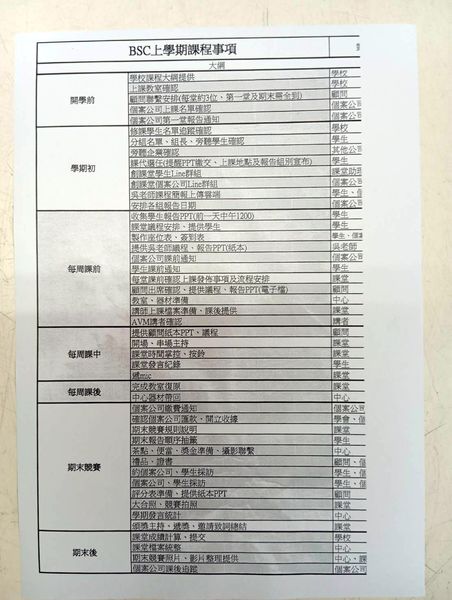

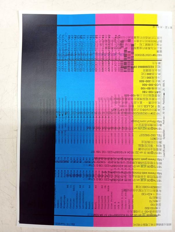

Every page printed all is beautiful but with right 2cm blank from top to bottom.
Both printed from PC or copy from the glass are the same.
If you look closely will see that color Y > M > C > K, Y is much shorter than M and > C and > K.
Color Y's blank length is shorter than 2cm, M is shorter, C is shorter, and K is almost 2cm exectly.

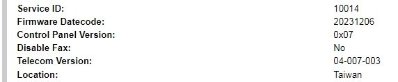

Firmware updated to the newest.

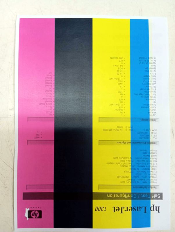

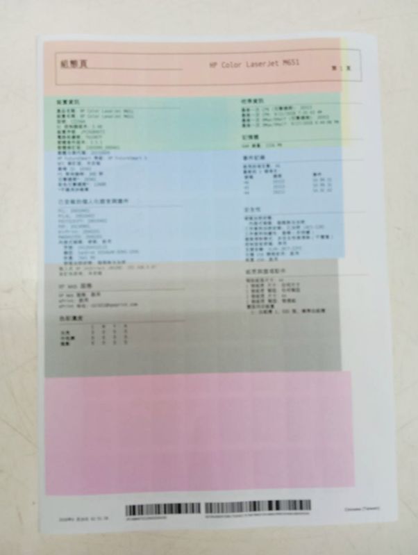

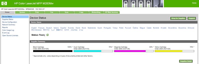

I print out a Quality Page  as seen in the picture, there're four different distance from right edge of color CMYK, Y's right edge is the smallest then color M then color C, and color K's right is the longest.
