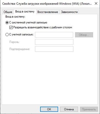

Please check the Windows Image Acquisition (WIA) service to see if it is working properly by doing the following:
  1. On the keyboard, press the Windows flag and the R key simultaneously. The Run window opens.
  2. Type services.msc and OK. The Services (local) window opens.
  3. Double-click on Windows Image Acquisition, then click on the Connection tab.
  4. Check Local System Account and Allow the service to interact with the office.
  5. Click on the Dependencies tab and check that Remote Procedure Call (RPC) and Kernel Hardware Detection exist in the first window.
  6. Click on the General tab, and restart the service by clicking on Stop, then Start.
  7. Close the Services window.
  8. Try to scan with HP Scan.

Dear Mans,
I tried all the options you suggested: I go to the printer via IP, HP scan did not work, and does not work. It doesn't wake up when I run an HP scan. Recycle printer?
