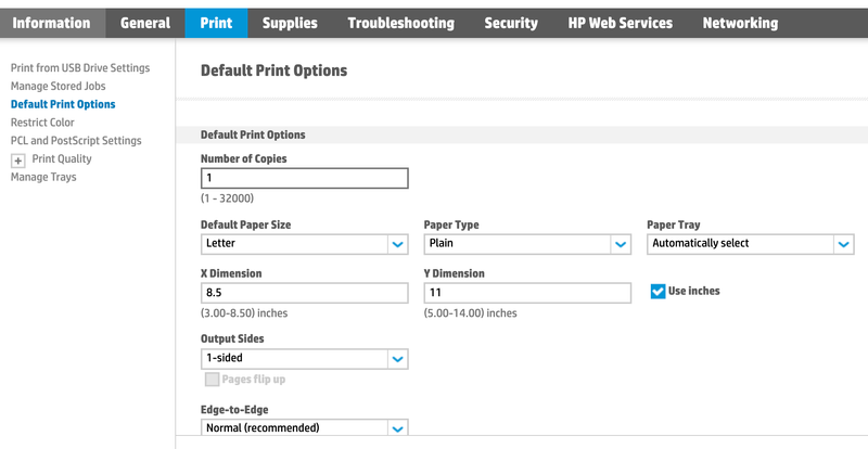

I upgraded the Firmware to 241117_063723 (the latest) and I did see a setting for single sided Screen Shot 2021-12-02 at 4.31.30 PM.png
and I selected that but I'm still getting duplex output.
