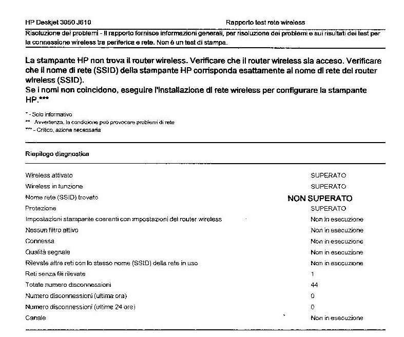

Here are the results. I have my language settings in Italian, I hope it's not too difficult to understand what's going on. In the 1st page it says the SSID on the printer and on the router don't match, however the SSID is only one, there aren't similar ones nearby. It also says to run the wireless installation to configure the printer, but that's what I've been trying so far! ☹️
I've been looking for a way to manually insert SSID and password, didn't find anything either...
(EDIT: I posted only the first part, other details weren't really as relevant)

As the network name is listed as Miro, is it your network SSID? If so that means the settings have been set for the printer.
