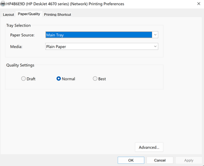

Device setting tab has no option for colour. just as seen below.
See...no option to set to Colour.
Tried it and then it asked to print a test page after it found no issues. Test print also printed all black instead of colour.
