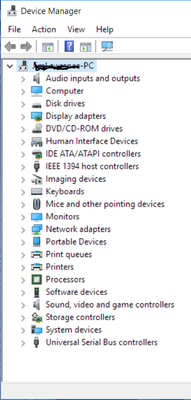

01-17-2017 09:25 AM - edited 01-17-2017 09:32 AM
I opened up the Device Manager and "multifunction adapter" is not listed (see below). I opened each folder also just to make sure it wasn't buried in there.
I also got into the Windows Firewall but couldn't find where to edit the port connections. I'm not sure I feel too comfortable changing settings there not knowing how that may impact the firewall and any other potential security issues. One other thing I tried a few days ago that I didn't mention earlier was to actually disable the firewall during the HP ENVY 7645 download/re-install. It only allowed the hardwire (USB) install but couldned dedect the wireless connection.

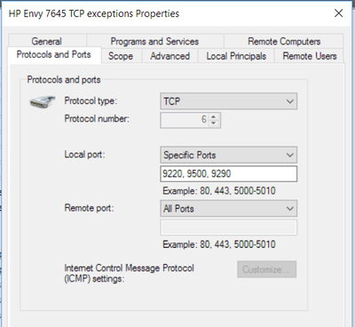

01-17-2017 05:46 PM
I really do appreciate your time in trying to get my printer's wireless connection back on line. However, after your last suggestion on adding Firewall exception ports using the numbers in an earlier comment, I still can't get the wireless connection back online with this one computer. As an alternative, I've reached out to the Microsoft Forums to see if there is a solution there. I still wecome more suggestions from you and others. Thank you.
