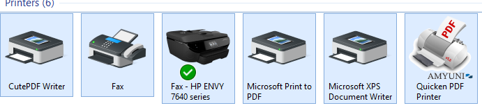

I still cannot install the printer either USB or wireless. Here are snapshots of device manager and devices.
snip2.PNGThe things I notice are that the scan and fax seem to work. If I print to the Fax - HP Envy "printer" it brings up a fax menu.
If I try to use device manager to update driver for the printer, it tells me it that the device is already installed with the best driver and to look on manufacturer's site for drivers.
If I try to update the USB NULL - printer it errors with "the printer driver is not compatible with a policy enabled on your comnputer that blocks NT 4.0 drivers".
I have tried every USB port on the system. I have also installed this printer to 2 laptops running Windows 10, one from an update and one that came with 10 installed. I can also print to it via my ipad.
