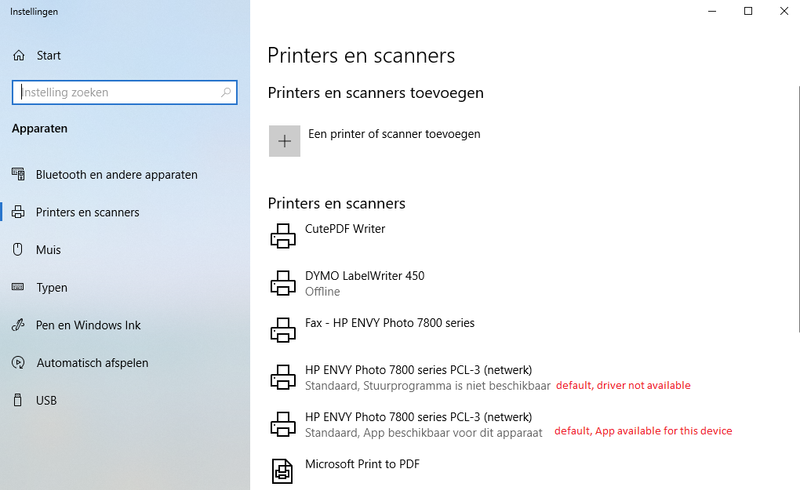

Now I see two printers with the same name in the devices and printers screen.
At one of them there is listed "default, driver not available" and next to the other is listed "default, App available for this device"
The first one doesn't have a printer queue attached. The second one does. Trying to print a test page from this queue still leads to the message that the test page could not be printed.
Obviously I can't try this from the first printer, because there is no queue attached to it.
When I try to print a page from Microsoft Word (I see the printer only once here), I notice that the print job appears in the printer queue and it immediately disappears again, without any error. No page is printed however.
See below the output of the "Devices and Printers" page. Unfortunately it is in Dutch, so I added the translations in red for your conveniance.
